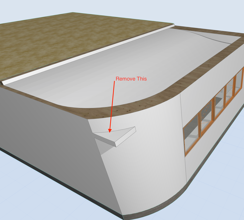

Hi everyone,
 I'm making a CAD model of a school building that has a lot of curves (this is just the beginning!) I have a ceiling that has a gently curve created using Complex Profiles, but it intersects with a curved wall. I would like to remove the section of the complex profile ceiling that sits outside the room, but I can't figure out how to do it. Any suggestions?
 Thanks in advance!

You could use a shell instead of a profile - its bendable for some cases like this. Shells can be edited (cutout holes and borders)) in the groundfloor-view (top-view when rotated) and can have multi-skins as well.
the other way would be a big enough morph-body for an SEO - command - intersection.
