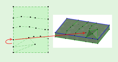

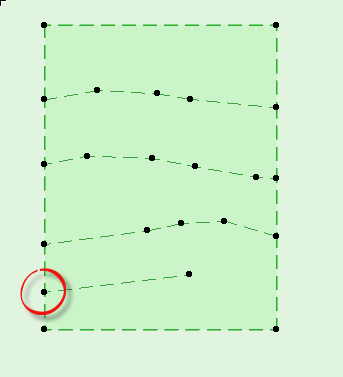

Yes, I can drag a single mesh node outside of the boundary and it disappears, but only if the node is connected to nothing. Yes, you can delete an entire contour line ridges. Yes, you can make a hole in the mesh around points to delete them, but then you need to redraw what you cut out and fix points that got changed that didn't need changed.
How do I delete a point that is on the edge of the mesh or one node out of a contour line? It just stacks points up at different elevations if I just move it on top of another point.  Can we not do this? Meshes get crazy complex even worse so by not being about to remove points. Seems like a very simple thing to add.

You don't have to move single node out of the mesh, with only that one node selected hit delete and it will be removed.
This doesn't work on boundary though. I'd always just drag the point on top of another one and that will always merge them.
But you do raise an interesting point (couldn't resist 😄 ), there is no function for removing nodes. GS, perhaps add X button to the pet palette?
gotphish001
That is incorrect. Moving a node onto another node that is on a boundary or a contour line does not merge them. It makes two nodes on top of each other that can have different elevations. My question still stands. There's no way to delete a node on a boundary or contour line.
Are you sure?
Meshes can not have nodes vertically above each other.
You must have a slight displacement in plan.
I just tried in plan and 3D and the nodes merge to one.
But having said that, I just played around adding a new ridge and then deleting those nodes.
Something I did in the process (I am not sure what) has now made it so that the mesh creates a new node when some of the edge nodes are moved.
Not for all nodes but just for some.
The original node will not move, but duplicates.
So there is something strange going on, but I don't know what exactly.
That duplicate node can be moved and does not duplicate again, and if moved over another node it merges.
If I move another node over the one that can not be moved, they do not merge, which is I think what you are experiencing.
Separate the nodes again in plan.
You should find one will move, the other won't, it will just duplicate.
I just tried to repeat this on a new mesh, and I can't.
Something in the editing of ridges and nodes seems to be corrupting some of the edge nodes.
I do have some nodes that I can't seem to move on the edge of the mesh. I 100% have points directly on top of each other that are different elevation. Unless when I'm snapping one to the other it doesn't put it exactly on top, but that seems like weird functionality.

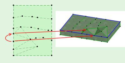

I don't think there is any problem with the precision.
Something is happening to some of the edge nodes.
Exactly what that is I am not sure.
But it seems a node is created that doesn't move but duplicates.
These nodes can be stacked on top of each other, which should not be possible.
It seems to me that some of these edge nodes are actually internal ridge node.
They can be moved over an edge node and both nodes still exist, they don't merge.
That is it.
I just created an internal ridge.
If I now move one of tho ridge nodes to the edge, it becomes an edge node but it is still a ridge node (if that makes any sense).
I can now elevate that node.
I can't move the node, it will just duplicate.
That copied node can be moved over any other node.
In this case it just becomes a 'free' node in 3D, but I have seen it drag the surface with it.
This is now 2 nodes stacked on top of each other, move one and the other will still be there.
And if I drag it further along, the original edge node is still there.
So actual edge nodes can't be stacked over other edge nodes - they will merge.
Ridge nodes can't be stacked over ridge nodes - they will merge.
But is seems you can move a ridge node to the edge, it will take control or the edge of the mess, but is not an edge node as such and will not merge with other edge nodes.
