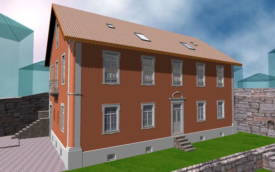

I have done a lot of work on that area.
At first, I found it took a LOT of effort to put everything into 3D. Sometimes I was building stuff that would not be used, or would not be altered, like ironworks and stuff.
I doubted that it was worth the effort.
But this is what I found out:

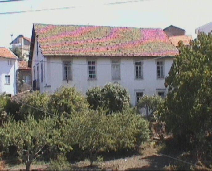

Before we had computer aid, the classic approach to do some renovation project was first to go to the building, and spend a lot of time sketching its details. Not only taking photos, but actually drawing the various components, allowed you to integrate the building into your mind, to become very familiar with all its visual and structural characteristics.
Now, building it into the computer has the same results. You become intimate with everything about the building. This is great, because when you go to the next stage, which is trying out some solutions, you already have them pretty much nailed down.
To give you an example:
This building was not so great looking. It was very old and in an apparently bad condition, and just by looking at it you could not discern its intrinsic value. The client wanted some major work done, with much demolition, and I was inclined to agree.
After I modeled the building, we both found out that, taking away all the vegetation, grime and alterations, this was indeed a jewel. Therefore, the intervention was minimal, as we tried to maintain as much as possible.
So, now I always transfer the building into the computer prior to starting to look for solutions. And I found out that doing so is fun (yeah, I know, architecture - especially CAD - isn't supposed to be fun...).
This is what the computer gave us...
