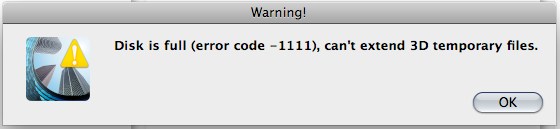

Disk is full (error code -1111), can't extend 3D temporary f

How much free drive space do you have? It sounds like you've run out of cache space on your hard drive.

Not likely the cause of the message, but 4 GB memory is not much for an 8 processor machine which is potentially running lots of background tasks besides ArchiCAD. So, virtual memory swapping on your hard drive might be part of the slow-down.
Is the issue repeatable? If so, run Activity Monitor while this is happening and (cmd-1) check the System Memory usage - amount free - and the Disk Activity read/write rates prior to the error appearing.
Assume you have lots of free space on your disk? The AC default location for the temporary folder for AC 10 is a hidden subfolder of the root of the boot drive. If you've partitioned your drive in such a way that the boot drive is short on space, that might be related to the problem?

The near-frozen slowness (with one of the processors apparently running 99-100% continuously) is repeatable. I guess the message will too at some point.
It happens the first time it generates a model, after that you can change viewpoint and walkthrough OK.
Only 10% of the drive space is taken, everything is on the server. The drive is not partitioned.

I've got same issue.
And what graphisoft answer to me:
The disk full error is probably as the result of windows reaching its 2GB limit. Try simplifying the visible parts of the model, truning off the internal layers etc.
