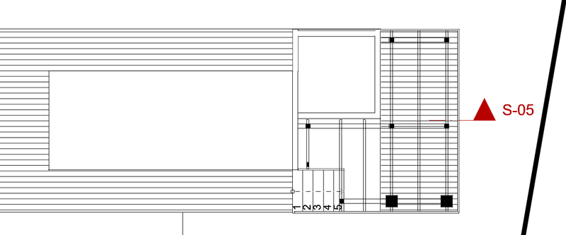

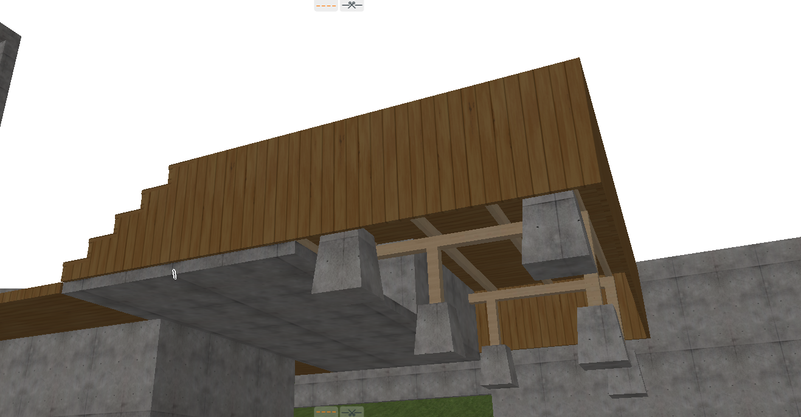

Hello. I can't figure out why the concrete slab that's UNDER the wooden deck is showing above. The cut plane is above the wooden deck and the display order has been reset to default order already. The same thing happens with the pool in the left.. the slab at the bottom of the pool is above everything, the pool walls and the deck that is above these walls.

This is just a display order setting issue.
What is not intuitively obvious is that the plan view display order of objects (that determines what objects will mask other objects) is not intrinsically linked to the 3D position, but is user controlled. You can set a ground floor slab to mask a roof above, if that is what you want for some reason. Occasionally this is useful, and occasionally it is annoying if not intended.
In other words the 2D plan view is not a true generated 'line of sight' projection looking down (you would need to create a separate true projected 3D view that corresponds to the 2D plan view if that is what you want - though you won't be able to use all your 2D-only tools directly in that view)
To control display order of an element in plan or other 2D view, you select an element then use the 'Display Order' menu to bring it forwards or send it backwards relative to others in the stack of overlaying elements in the area.

2022-11-28 02:34 AM
or your wooden deck cover fill is set to transparent that's why even you adjust the display order it will still be seen.

Why would that be normal, that plans are "2D plan view is not a true generated 'line of sight' projection" ? I mean I don't see the reason why I would want a slab that is in a lower level in 3d to show up above a higher located one. Can you explain me the logic? Otherwise I would suggest a wish to be added, as I find it very confusing..
Saturday - last edited Saturday
Because sometimes what you want to communicate to the builder is not visible via line of sight. For example, footings that project out beyond the slab edge, that are hidden underground, slab thickenings under load bearing walls, slabs and footings under timber decking etc - all need to display (typically as dashed lines) through things that would mask them if a pure line of sight mode was imposed. that said, maybe you could make a wish for 'line of sight' mode that masks everything hidden that is not wanted in a presentation view, so user doesn't need to mess around with multiple layers and combos to achieve same outcome. Maybe you could include other features in this display mode that you think are relevant to making drawings look good, without resorting to 3D documents?
