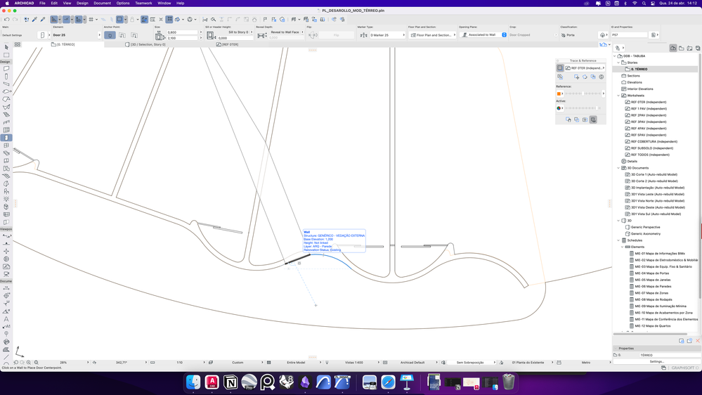

I'm had to create walls with polygonal method on this project because some details of was impossible with simplified methods, then when starting creating my doors i've got this problem:
My main thought was this is a reference problem cause when your start draw polygonal walls us must specify which side was the reference line, but even when changed still with same problem. So I don't know what to do right now, anyone had this kind of issue?

If it is a single polygon wall, it thinks the opening needs to go through the entire polygon, which is understandable as there is no depth limit to the opening.
You will need to break the wall into multiple parts.

I had to cut my walls in pieces to resolve this one, its sad cause this pieces lines will appear on the project šŸ˜£
Lingwisyer
Guru
If your wall connection is planar, there should be no line.
