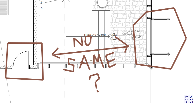

Door View in Curtain Wall
Dear allL
How come the door in Curtain wall see different from the door in Wall?
(See Screencap)
Anyone can help ,
please thanks!

In the Floor Plan and Section panel of the Curtain Wall Settings Dialog, what is the Floor Plan Display field set to? Is it set to Symbolic? Or Projected? Symbolic should give you the representation you need. Try to experiment with that field.
Thanx! it works!
