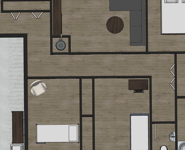

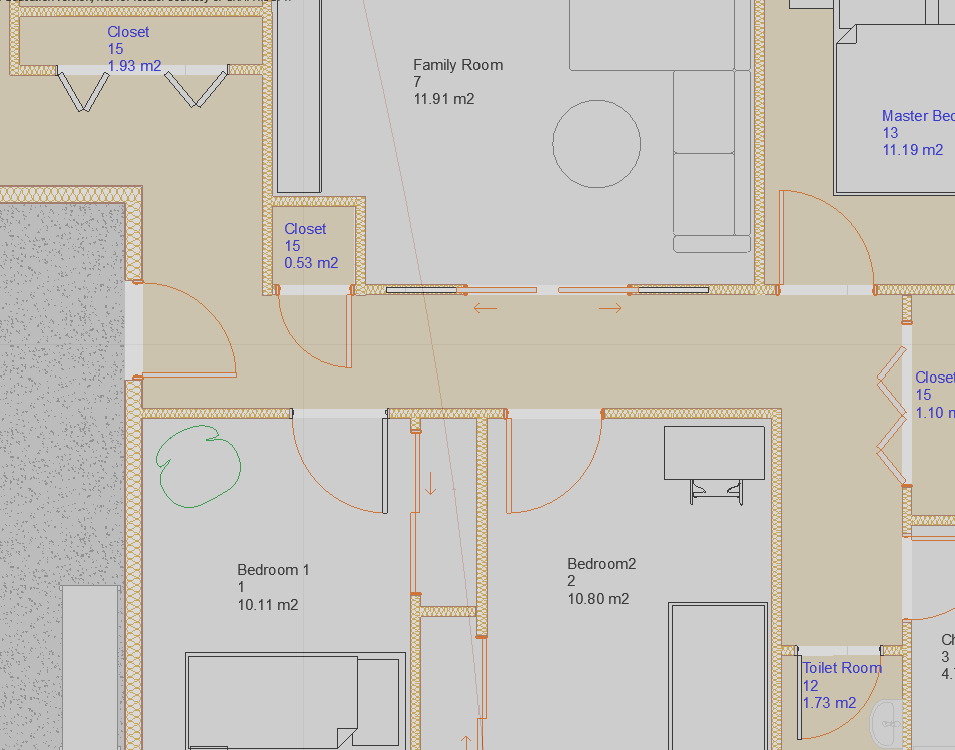

Hello,
I am new to Archicad (using 24 EDU version) and am struggling with my 3D view. I have gone through all the settings but cannot see why my doors show up on my 2D plan (see attached) but not on my 3D top-down cutaway view (also attached). A few doors show up, but most do not. None of the window openings show which I'd like to see from this perspective.
I have searched the forum but have not been able to find a solution. If anyone can help, I'd be most appreciative!

2022-08-20 12:09 PM
How are you generating your 3D view? Is the cutting plane through the walls in 3D low enough to cut through the actual doors or is it positioned at the first floor storey level so is above the door head height?

2022-08-20 06:15 PM
@atk123 Hopefully you are using 3D Document from Plan in which case adjusting the cut plane is easy in the settings? As @Lee Hankins has suggested your cut plane appears to be set above your openings.
2022-08-20 08:19 PM
I assume you’ve a 3D axonometric top view and you use filter elements in 3D to display one floor plan this case you should use 3D cutting planes to adjust the cutting height to be lower than door heading as @Lee Hankins said then you select all doors and from door settings panel search for opening angle and in 3D box type 90 degree or whatever you like, I hope that helps.
2022-08-20 10:15 PM
Thanks, Lee. I lowered the cut as suggested which worked perfectly for viewing window openings. However, most of the doors are still not visible. I can see the openings, but not the doors. Settings are same for those visible vs not as far as I can tell. Hinged with opening, etc. Would there be a wall setting or anything else causing this problem? It appears exterior doors are showing okay, as are those within newly added walls. Thanks again

2022-08-20 10:21 PM
I've also tried injecting the parameters from a door that is visible to one that's not and it makes no difference.

2022-08-20 11:29 PM
@Lee Hankins I have deleted old doors and created new doors and it seems to show on 3D now. Not sure what was wrong with original setup? Thanks very much for your help.
