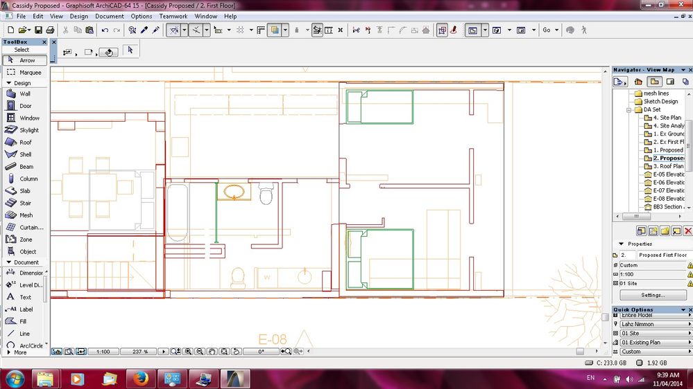

I feel like i've checked and unchecked every box but none of my doors are displaying on any of the plan views or elevations ( i can see them in 3D) they just appear as openings.
Any help appreciated!

A screen shot would help. Have you checked Model View Options?

here is a screen shot all doors appear just as blank openings (also some of walls have 'ghost' of demolition layers cut through, would like to hide these if possible. thanks for your help!

Check your '01 Site' Model View Option as Stuart mentioned.
I think you will find your doors and windows are set to show openings only.

thank you!
