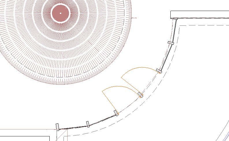

Double door on curtain wall with deleting one mullion !!
Hi everyone i want to delete one mullion frame and that will result in joining two panels so here i will put double door.
How i can make this happen
setting it into invisible will not solving my problem that i have two panels
taking also into consideration what if i have in future irregular division of frames
thanks

Edit the polygon of the Curtain Wall on the Floor Plan so it is made up of segments the way you want it.
I suspect you have drawn an arc on the Floor Plan and the curtain wall tool segmented it so now you have 6 segments. These behave like 6 individual curtain wall planes that and handled as a unit. The problem is that those two segments are not in the same plane. You will have to make them be in the same plane in order to be able to put that double door in there.
So segment it to the exact way you want.
Use the Chained method of the Curtain Wall using the existing Curtain Wall for the points of the nodes.

i used chain method but i make it space in curtain wall setting so it becomes 6 segments. i took plan shot to clearify that i can not delete the mullion in the middle and make instead of it double door.

What I am saying is that you create it using the chained method but make it only 5 segments. The total length of the double door should be one segment (so it will be about double the length of the other segments).

When you are in the 3D Window as per your screen shot, you should be able to select just one of the vertical Scheme lines then delete it, combining the two adjacent panels into one for the double door, but the panels above will also be combined.

David thanks for reply , but i am not able to choose one of them , when i select it select them all. which will not enable me to delete any mullion.
Erika Epstein
The round/arced curtain walls as you show will not allow you to delete a vertical frame that is on the scheme settings.
Along the lines of Laszlo's advice, in your situation you could redefine the panel widths in the scheme settings as shown placing the door in the sequence of panels per the screen shot.

Not sure why, it works here. In 3D Window select Curtain Wall, click on edit button, turn on Scheme, turn off Frame and Panel, move cursor over vertical scheme line to be removed, click on it, hit Delete button.
