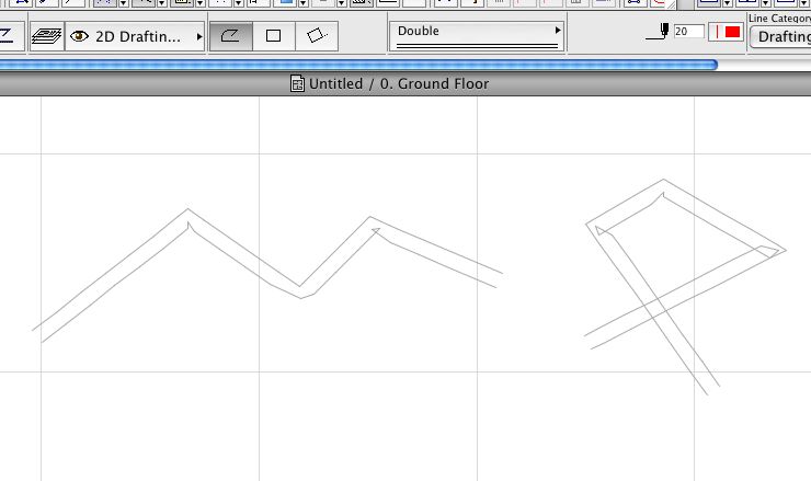

I tried to draft some double lines and got some very strange results. It is standard AC linetype, that gets odd on corners. I created also my own simbol linetype and the troubles at the corners are even worse. Any idea?

Luka, a poly line will always give that result.
Instead use a grouped line.
Depending which way you draw your grouped
line it will give 2 different results.
Try and see the result. Better than a poly line,
but a line I rarely use.
