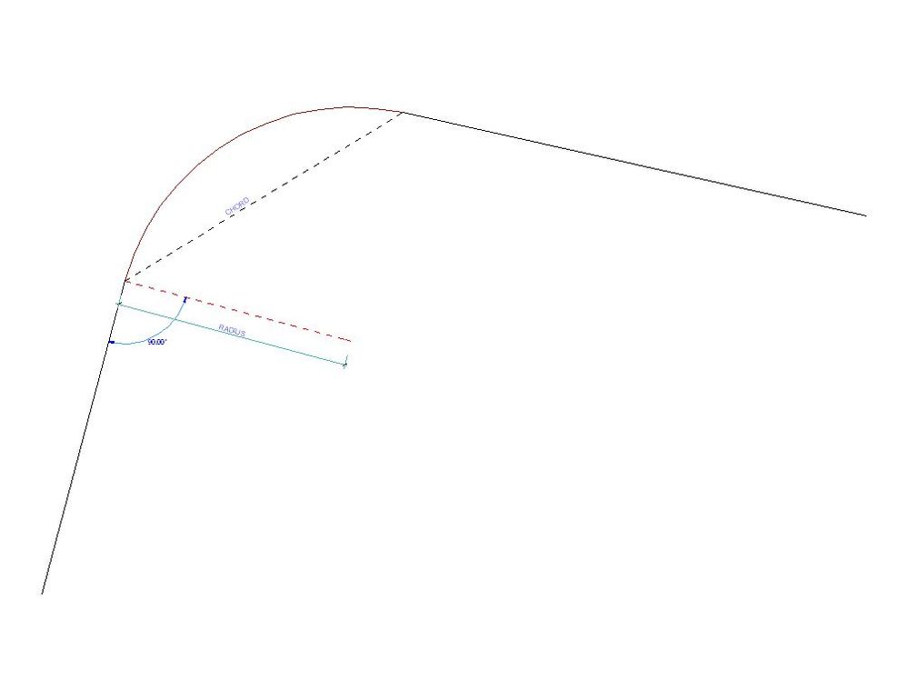

I am working from a surveyor's drawing, and need to input the arc length with a given radius.

Any arc I have drawn (from a survey) has been in tangent with a line or another arc. I just go 90 degrees from the endpoint to find the center of the radius.

I don't follow how you go 90 degrees from the end point to find the center of the radius. Can you give my dim mind a screen shot of what you are doing to get a surveoir's arc.

This example might be a little simplistic, but here it is. Hope it helps.
Steve

Thanks much for the screen shot, it really helped. Which Arc/Circle tool are you using? If I use the Three Point Tool I can draw the cord, constrain 90 degrees with the perpendicular icon, but then I must pull the diameter of the arc to get the radius. Is that how you do it?

Another method is to draw a circle of the known radius at each end of the chord. Where the two circles intersect is the center of the arc you are looking for.

I use the center point circle.

After further investigation, I have found the three point circle tool does not work for a chord arc as I had previously posted. It only seems to work if the radius is large. The three point circle tool will work for a chord arc if you bisect the chord and and graphiclly input the chord rise which equals r-½ the square root of (4r²-c²). But this is more effort then either Stephen's or Erika's posts.
So I guess it is back to drawing circles. ':('
