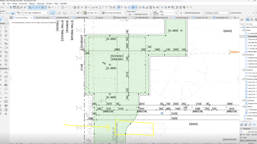

Could you please help me how to draw a curved driveway? I used the fillet for the other side but I'm not able to use that for the this side which I highlighted.
1 Solution
mthd
Hi @Farnoush Pourmoradi, it’s fine to keep your question in the same post. I hope I can help you. It appears that you have two nodes inside your yellow square. Try deleting your fillet and just add new nodes to those points using the pet pallet as shown in the other post. You could add hot spots to those two nodes to mark their current position. Try that and see if that helps ?
