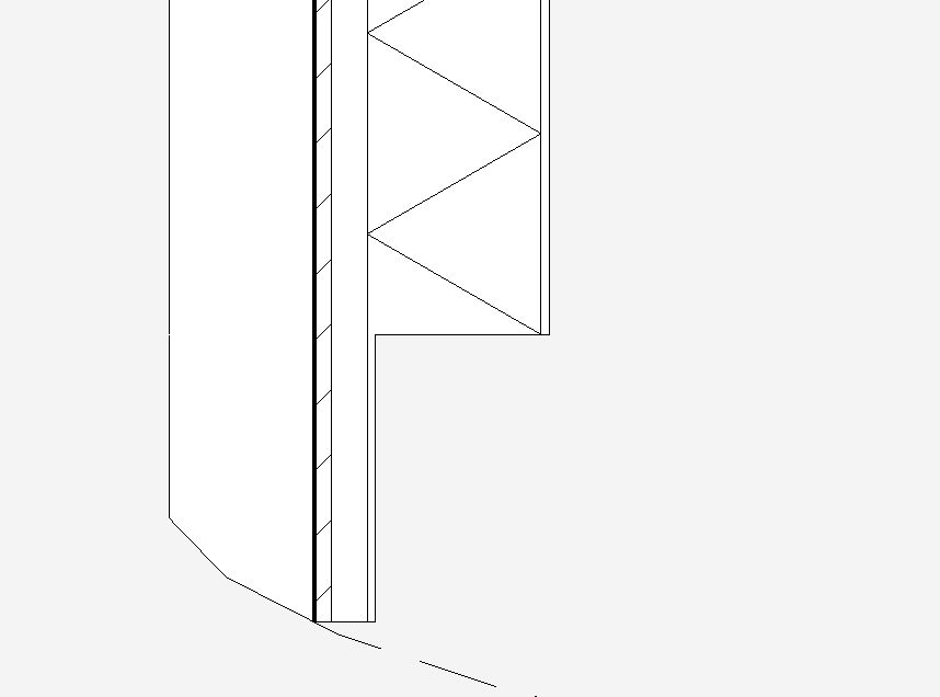

Hi!
If I have an insulated roof, at say 300mm deep, when it gets beyond the external wall I need it to be shallower so that I don't have a massively deep fascia.
What is the cleanest most efficient way of doing this?

You can merge two roofs, so you can have two composites of different structure for the part that extends outside. Select both roofs, right click, connect > merge elements.
Since the top layers of your composites will be the same, you will not see any lines in plan view. Elevation/section will look fine too, but ussually just having the same surfaces will solve this.
The problem with SEO is that you end up cutting away bits of the composite that you do not want to lose, generally.
This also works with shells.
