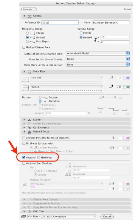

Tom Waltz
I have a Vectorial Fill assigned to my designated material. I have the Show Vectorial Fill option checked on my On-Screen View Options clicked.
However,
I still cannot see the Fill on my section/elevation. Is there an option somewhere in the section/elevation settings? Perhaps somewhere else?
thanks again,
-matt
TomWaltz
However,
thanks again,
-matt
Yep. It's in the section marker:
Tom Waltz
