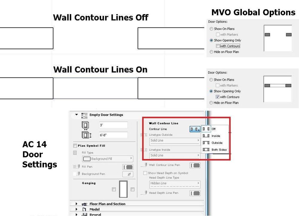

Karl wrote:
In the MVO dialog, you must check the boxes for "with contours".
Karl, correct me if I am wrong, I thought this feature was only intended to show the contours on the two sides of the wall, not the sides of an opening. The sides of an opening should have a contour defacto. Am I not correct?
In AC 14 this model view option is available in the door settings and even the dropdown icons show a contour line on the sides of the opening in all variations. Also tested the global MVO with the same results.
Vlad, perhaps there might be a display order issue at fault. Try selecting the door or wall and change the display order Edit>Display Order.

Karl Ottenstein
Moderator Emeritus
You're right, Nicholas. The MVO option shows the side AND the in-line wall contours.
If the MVO is to show door/window, then the door/window contour setting must be off to show the wall end lines.
But, at least on Mac, if I switch MVO to show opening only, then actual windows show wall ends but empty openings still do not and I don't see a way of forcing them to show?
