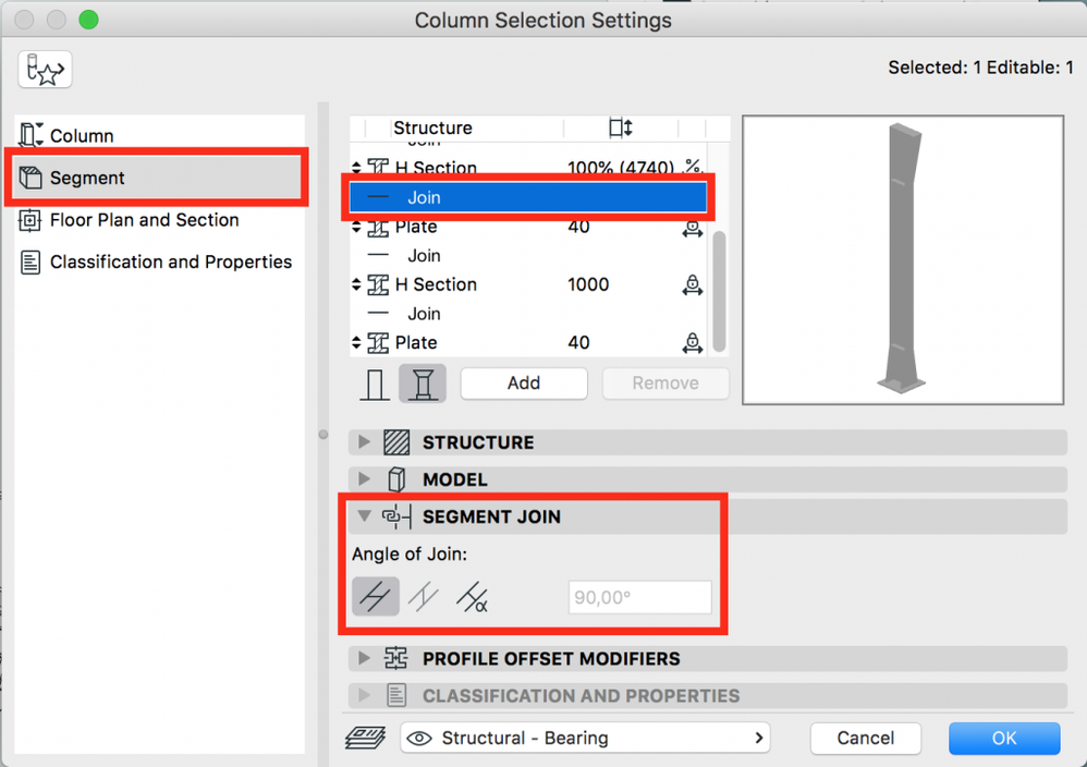

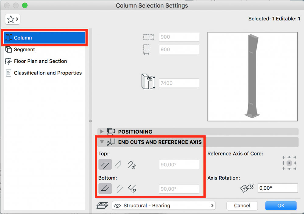

Modifying angles in the Settings Dialog
In the settings dialog, you can numerically input the angle values:
Beam end cut setting
Beam segment join setting
Column end cut setting
Column segment join setting

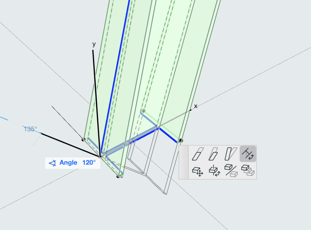

Modifying angles in the 3D window
In the 3D window, you can rotate the segment join plane and the end cut plane using the Pet Palette command Rotate Join Angle. (The command is named the same way and its icon looks the same in all of these cases, although, the Pet Palette's content is changing depending on where you clicked.)
You can rotate the end cut and the segment join planes graphically when the whole beam or column is selected and also when you are in Edit mode and only one segment is selected. The change of the angle is then shown in the Settings dialog too.
Modifying beam segment join angle
Modifying column end cut angle
