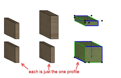

‎2023-05-22 02:03 PM
Thank you both, yes you are right.
I was thinking that if you wanna make likehaving a double profile and have control over some parameters.
Something like this, where both objects are the same profile, not sure if I'm explaining myself properly 😅
Juan

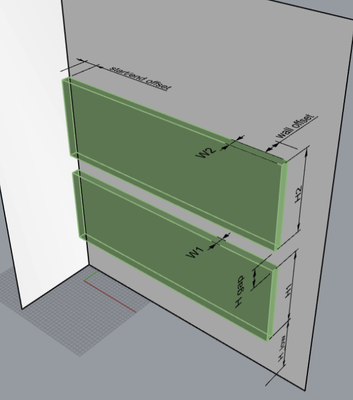

‎2023-05-22 04:14 PM - edited ‎2023-05-22 04:17 PM
You can create a single profile with two separate fills - they don't have to be joined.
You can also add modifiers to allow you to stretch H1, H2, Hgap, W1, W2 and even the wall offset (although for that it is easier to just place the beam at the offset you want).
I am assuming the profile is the end of those beams/walls.
Research modifiers in complex profiles.

‎2023-05-22 04:24 PM - edited ‎2023-05-22 04:25 PM
For example...
And now the profile is stretchy in section/3D.
