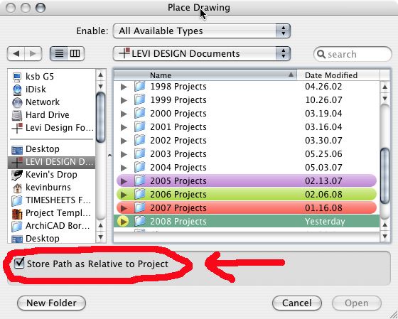

Is there a way to set the default so that the external drawing path is absolute (ie. the checkbox in the save dialog is unchecked) rather than the preset default value of relative.
As most of the external drawings we place are on our server, the prefered method seems to be absolute. When set to relative, with multiple users involved, especially on teamwork files, it seems like the linked files need to be updated more often and we have had some instances where things don't get updated as they should before getting sent out.

You would think it would be an easy fix, the option is there in the place drawing dialog box (see attached), if you remember to uncheck the box no problem. The problem is most people overlook the box and forget to uncheck when they are doing the placing.
I'm no programmer but it should be an easy fix, since the checkbox is there, to make the checkbox be unselected as the default.

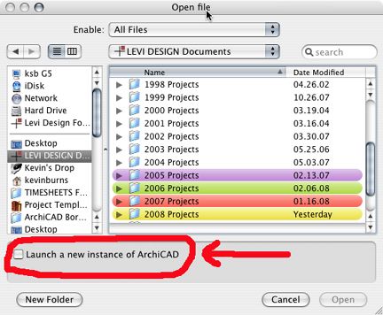

And there are other dialog boxes (like the open dialog where the checkbox is to launch a new instance of ArchiCAD), where the unchecked state is the default. Someone in programming made the seemingly arbitrary decision of which is the better default state. I disagree in both these cases, it seems other do to so changing it should be an option, and an easy one at that to fix.

The open dialog default, for the record

AFAIK, this cannot be set as the default or by alt-clicking an existing drawing.
The only method I know to set it before placing it is:
1. Go to a layout,
2. Select the Drawing tool,
3. Click on the layout,
4. The 'Place Drawing' dialog appears, where you can select "an external source",
5. Then press the "Browse" button and the "Link To" dialog appears,
6. On the "Link To" dialog you can find the "Store Path as Relative to Project". This is where you can check it or uncheck it.
Unfortunately this won't work for subsequent drawings, and AFAIK external drawings will always come in as absolute, so you'll need to repeat this procedure every time you want a Relative drawing.
