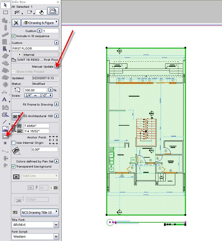

Srinivas
TomWaltz wrote:
I just keep all my drawings set to Manual.
Here is how you do it. Just incase you didn't know. or you select all the layouts in the drawing manage double clik the drawing tool and in the identification tab you will see Auto/Manual updates.

Link
Graphisoft Partner
Graphisoft Partner
Would be much easier to use the Drawing Manager to set them all at one time.

Agh! I always set my stuff to manual too so, but there was other stuff in the template in automatic.
Thanks.
