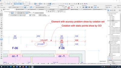

BrunoH
To help solving that type of mistakes, for example, i have created a cotation set that clearly highlight acuracy problems and a GO that show static cotation problems. Every one in the office work with this.
