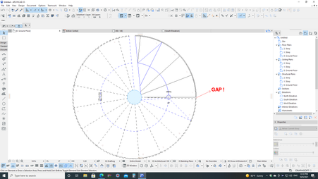

Is it possible to have the same start point and endpoint for a Spiral Stair ? Wich means an angle of rotation of 360º. I tried..it didn't work.

No, has to be split into two in my experience

Screenshot (2).pngCan you please explain your method of splitting the spiral stair in order to avoid that gap between the start and endpoints.
Thank you
