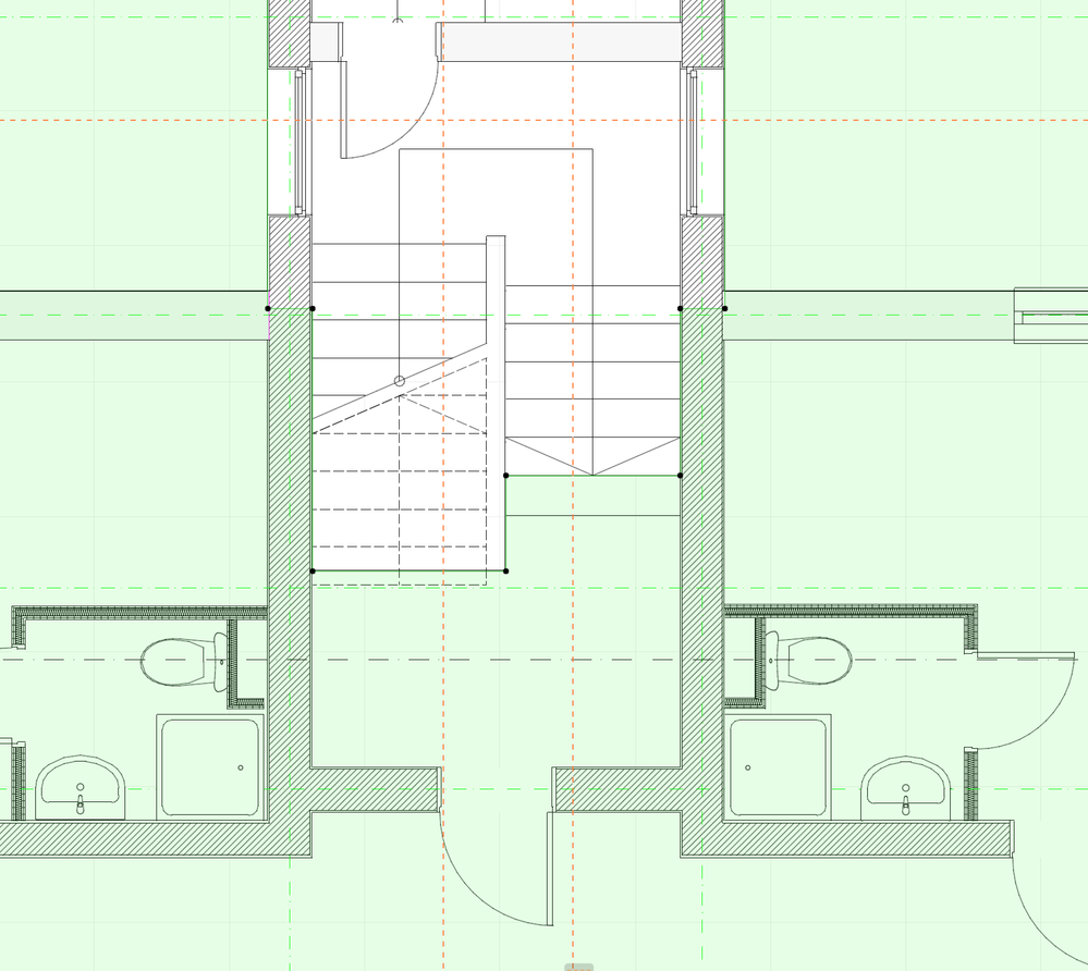

Hi everyone,
I’m modeling a stair in Archicad and have set up the landing with Support Connections > Horizontal Cut with Cut Out, which gives me the correct 3D result.
However, in the 2D plan view, I’m seeing an extra unwanted line where the landing meets the floor slab above (even though the slab is above the cut-out).

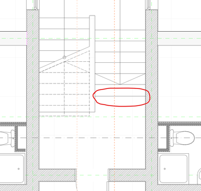

This is the line that belongs to the stair that i want to hide/delete
Has anyone encountered this? Is there a way to hide or clean up this line in the 2D representation?

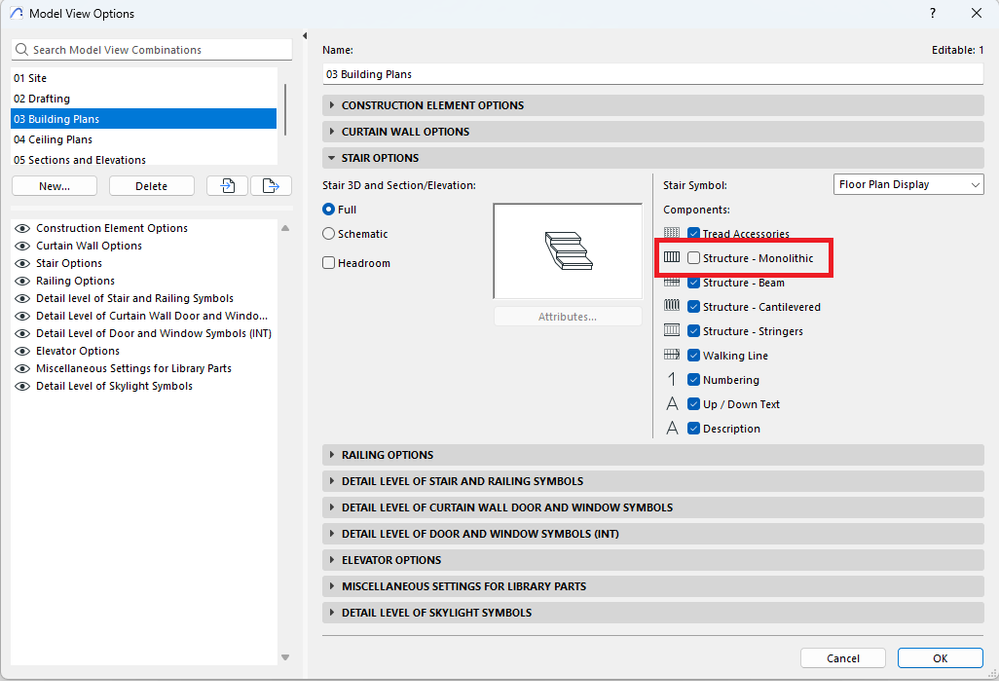

I think that is the line of the Structure where it meets the bottom of the upper Slab.
Try turning off the Floor Plan display of the "Structure - Monolithic" component of the Stair Symbol in the Model View Options Dialog.

Hi @Laszlo Nagy  ,
Thanks for the tip, I did not realize about the model view setting, I was looking all the time on the stairs edit mode and the stairs settings.
Thanks for the time to reply!
