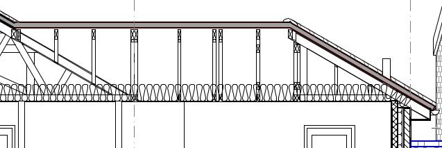

Has anyone else worked out a quick and easy way to do this?
(see picture)
The convention, in South Africa at least (not too sure about the rest of the world), for showing new timber in section is with a cross from corner to corner, but I have to touch up "by hand" all my purlins, rafters, wall plates, etc, etc, etc in section and it can be a bit tedious. I thought I might be able to create a new fill that could stretch to fill the cut surface rather than tile, but that doesn't seem to be possible.
Any suggestions?

jamespage11 wrote:
The convention, in South Africa at least (not too sure about the rest of the world), for showing new timber in section is with a cross from corner to corner[]. Any suggestions?
Try modelling the framing with OBJECTiVE. Many of the timber objects bundled with the software provide an option to show a single or double line in section (see image).

jamespage11
Thanks Ralph for the suggestion. That's exactly what I want to do!
But $300 is a bit steep just to hatch a few timber sections (although I'm sure the software does a lot more than that too.)
Surely there must be an easier (cheaper) way to do this in ArchiCAD itself?

It can be done with complex profiles. And I know it has been discussed here before as I was part of one of the conversations. Try a search with complex profiles and top plates and/or studs.

Thanks Link, I had done a search before posting and saw some things about using custom profiles, but it would still be nice if there was a simple fill that could be streched rather than tiled, or something to that effect, which could be used with all ArchiCAD elements; the curtain wall, roof wizard, objects, beams, slabs etc; rather than always having to model up any timber I need with custom profiles.
