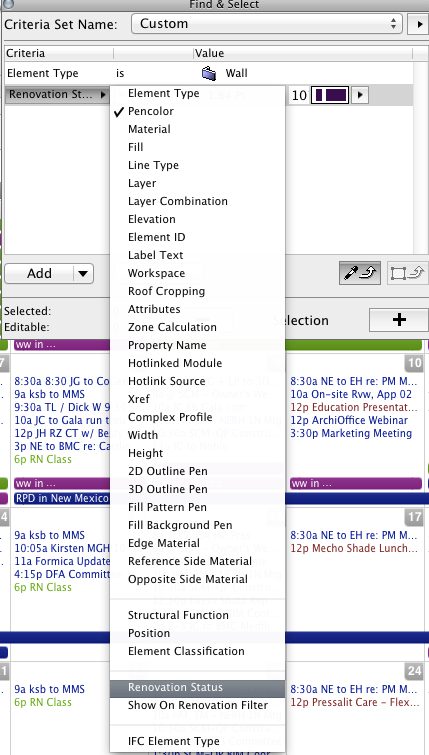

Why is the Renovation Status not always available as a criteria in the Find & Select dialog box?
It seemingly appears and disappears and I can't figure out why. I'm assuming there is a setting somewhere that is getting toggled, or something else I have turned on or selected is causing it but I can't figure it out. Something in display options maybe?

One possibility is that you have an Element Type (like the Section Tool) selected as a criteria, which does not have a Renovation Status.

Thought of that but no, walls for instance sometimes do not have renovation status available as a find and select parameter, but only sometimes.
I will post some images of example from same project, opened at two different times. Attached here is with it not available.

Same file, opened at different time.

Anyone else running into this? Know a cause/solution/workaround?

I've never seen the Renovation Status pop up as a Find option... at least you got lucky a few times!
Generally, I change my Renovation Filter to one that only shows the elements with the status I want to select and alter. This requires that your template have every combination of Renovation Filters available (new only, demo only, existing only, new + demo, new + existing, existing + demo, and show everything).
