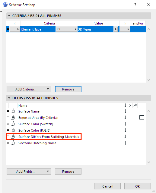

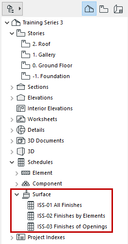

Hi, this has a solution.
Create a new Surface Schedule (the one with a paintbrush icon) in the fields just click "add" and scroll to the surface dropdown, you'll find a specific field for "surface differs from building material" (which means there's an override).
Cheers!
