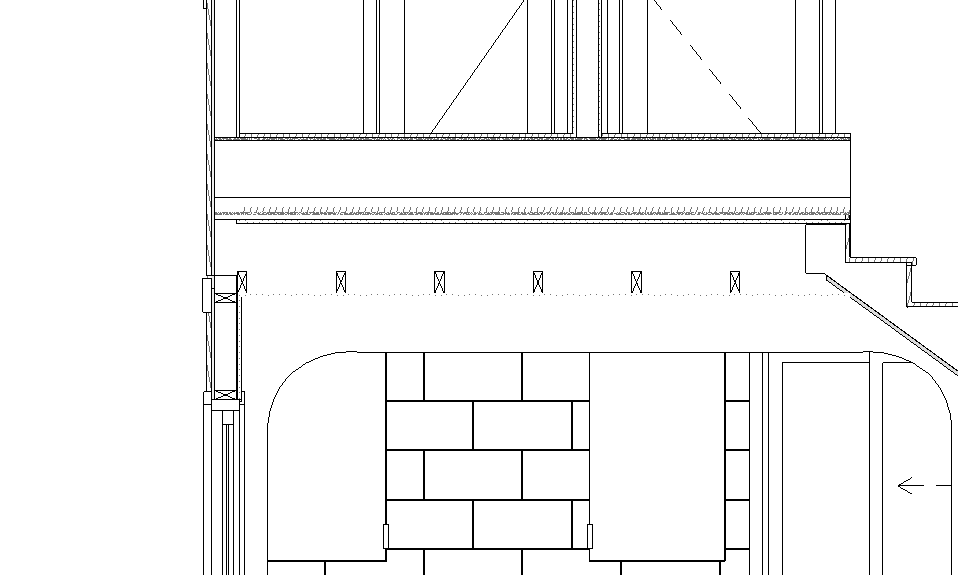

I am trying to make a slightly detailed building section and having a strange issue with my floor composite. The composite displays the fills but not the skin lines where it is positioned in the model. Here's the weird thing (and the reason why I'm pretty sure it's not graphic overrides/model view, etc) when I move the floor (say up 1'), the lines then do show up. I'm attaching an image of it as-is and then another where the floor is moved up 1', displaying the lines as it should. Any help would be much appreciated.

UPDATE: I figured it out! For whatever reason, there were two floors in the same spot. I guess somehow they cancelled each other out.
