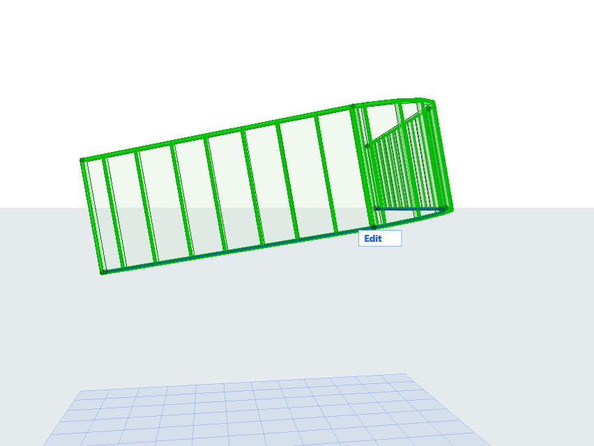

Hello, I'm looking for a workaround for creating a chamfered curtain wall slanted at 10 degrees like a truncated cone. It seems when I try this, the slant is only able to work on one plane and falls below the floor level when you try a 90-degree corner. Attached is a screen capture for it to make more sense!

You can lean a curtain wall on a segment but not on a curve.
I wonder if this type of curved, leaning curtain wall is otherwise feasible in the real world.
