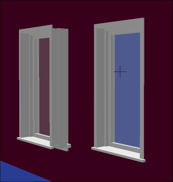

Of course freestanding windows can happen in Archicad.
Select any window in the plan view.
"Save Selection As" an object.
You need to jig a symbol, but there it is, floating in space.
Viola!!

You could also place a little piece of wall and place an real window in it. The wall only needs to be big enough such that you can CLICK a window into it.

Neither way cuts the imported wall - you still need to block it out with an SEO.
