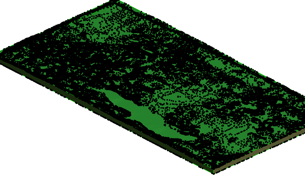

You all may be familiar with the AC14 new option "Place Mesh From Surveyors Data"...
It is a really fast way to create real terrains with just a few clicks. The only problem is that you will need a txt or a xyz file, and not all surveys provide with them, some will give you a dwg containing contour lines at real height.
There is a workaround to use the "mesh from surveyors" option with that dwg file:
  • 1- open the DWG as an object
    2- copy the 3D script to a text editor (just the lines) and save it as txt
    3- open the file in MS excel (using commas as separators)
    3- use find & replace to replace the LIN_ text with a space
    4- at this moment you will have 6 columns
    5- take the last 3 and place them at the end so you can have a list of X, Y and Z values
    6- save it as a txt , again using commas as separators
now you can use the "mesh from surveyors" option by selecting the txt file.
It worked for me with more than 12000 points, so it pretty reliable.
just be aware of the amount of polygons generated when viewing on 3D.
Let me know if any clarification is needed.

What he is doing is editing the text of the 3D script to convert lines into XYZ point coordinates. If your library part script has LIN_ statements in it (which it probably will if it is not binary) these will each have six arguments (the XYZ coordinates for the start and end points). He is then copy/pasting the text into a text editor and then exporting to Excel to extract just the end point XYZ values as an ordered list. This can then be converted to a mesh in AC14.
This might work for your Google Earth terrain if the GDL script has the stuff you need.
BTW: To open the library part the easiest way is to select it and press command/control + option/alt + O (that's the letter O not zero). You can also find it under the file menu.

In case it is not obvious to folks, this still does require that the DWG contain a 3D terrain representation. If your surveyor only sends a 2D DWG (as 2D site contours), you won't have any elevation data.

And yes, I have to clarify that contour lines on real height are required in the original DWG.
