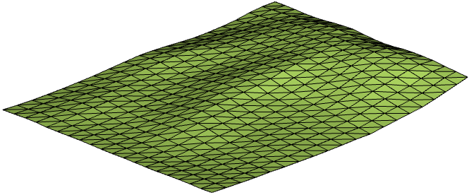

You all may be familiar with the AC14 new option "Place Mesh From Surveyors Data"...
It is a really fast way to create real terrains with just a few clicks. The only problem is that you will need a txt or a xyz file, and not all surveys provide with them, some will give you a dwg containing contour lines at real height.
There is a workaround to use the "mesh from surveyors" option with that dwg file:
  • 1- open the DWG as an object
    2- copy the 3D script to a text editor (just the lines) and save it as txt
    3- open the file in MS excel (using commas as separators)
    3- use find & replace to replace the LIN_ text with a space
    4- at this moment you will have 6 columns
    5- take the last 3 and place them at the end so you can have a list of X, Y and Z values
    6- save it as a txt , again using commas as separators
now you can use the "mesh from surveyors" option by selecting the txt file.
It worked for me with more than 12000 points, so it pretty reliable.
just be aware of the amount of polygons generated when viewing on 3D.
Let me know if any clarification is needed.

a couple of comments:
The DWG provided by Ravoneldar is a different kind of topographic file: instead of having contour lines with heights, contains 3D planes with heights as well.
But it serves a good example:
The main difference in the process is that instead of finding LINE_ statements you will find PLANE_ statements. Nevertheless you still have the information you want: ---X---, ---Y---, ---Z--- values for each point.
The TXT created with this DWG requires a bit more of "cleaning" before you save the final TXT for import into Archicad.

I try not to do baby sitting when helping others. Nevertheless this is not an "out-of-the-book" procedure so I can offer you a deal:
Here is the TXT file you will need to create your Mesh, it is important for you to try to understand the procedure. Then you do your mesh.
The procedure to obtain this TXT file was:
1- Open the DWG as an Object
2- Copy the 3D script and Paste it into a simple text editor like Notepad/Textedit
3- Save it as TXT
4- Open the TXT in MS Excel
5- Clean the content in order to obtain separate columns with X,Y,Z values
6- Save it again as (the final)TXT

you're absoloutly right. I'm sorry for bothering you but i'm trying this stuff for days. The problem was I had nothing to get an example. Anyway I have an example right now. Thank you for helping me again.
And I know how to do it now. I got my mistake. It was commas and so many numbers after the point.
Awesome Tip !
Got it to work on 2 big sites. One had LIN_ and the other had PLANE_.
When I copied the GDL in Excel I had 85000 points, so I added another column to concatenate X-Y-Z and then clicked Remove Duplicates based on this column.
Whether it's LIN_ or PLANE_ there is bound to be lots of duplicates because the start point of LIN_ or PLANE_ is likely to be the end point of another (or several others for PLANE_).
After Removing the Duplicates I ended up with 21000 points.
ArchiCAD imported it instantly and the Mesh is super fast and clean in both 3D and elevation and the file size is still small.
Thanks Nando !
