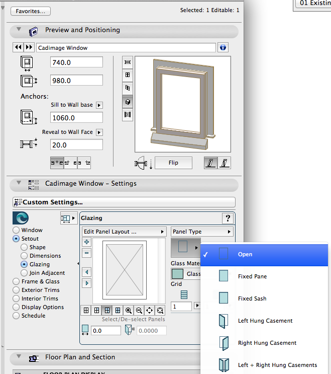

If you're using Cadimage windows, select the Open panel type
Yes I am, so perfect, thanks Stu!
