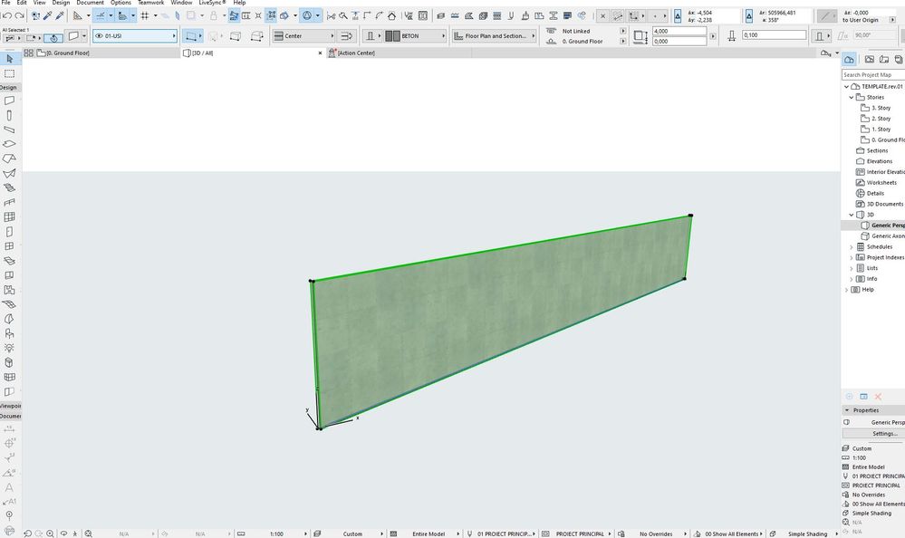

Hi! I have a little big problem, when I place a wall far from origin everything is ok, but when I move them to origin, or closer to origin it became to have a fuzzy surface and everything strange and glitchy. Can you help me pls? Sorry for my bad english.
1 Solution
Lingwisyer
Guru
https://help.graphisoft.com/ac/25/int/_ac25_help/030_Interaction/030_Interaction-23.htm#:~:text=Ther....
Go to post
1 Reply 1
Lingwisyer
Guru
