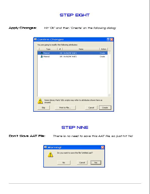

Here is a tip that I originally created for my clients, but since the topic has been discussed on ArchiCAD-Talk lately, I thought I would share it with the whole community. It shows users how to globally change a material throughout a project, whether the material has been assigned or not.
I encourage setting up default materials in your template file, that are assigned to each building element. Eg. Default Roofing, Default Flooring, Default Ceiling, Default Object, etc. These default materials can be simply copies of 'Whitewash'. This way when you first render your model, everything is just white, similar to a styrofoam model 'from the old days' . The client doesn't get distracted by the crazy colors you've picked and you can very quickly swap out materials globally, using the methods described in my tip.
I have each page shown separately here, but also have the entire tip as a PDF. I you would like a copy of it, please contact me privately!
Cheers,
Link.
