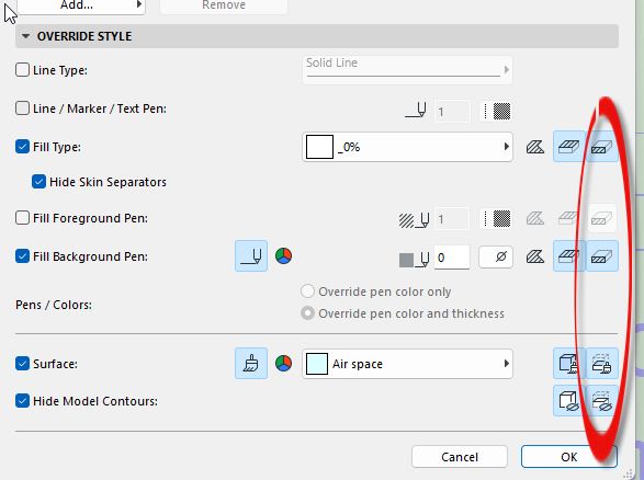

Hi there,
I have a graphic override turned on that essentially turns objects grey depending on what stage of the project they are classified as. However, in section, when these objects are cut, (for example slabs), they lose their graphic override and show as usual. Is there an option for this?
Operating system used: Mac Intel-based Sonoma
1 REPLY 1
Do you have all of your override options for cut surfaces turned on?
