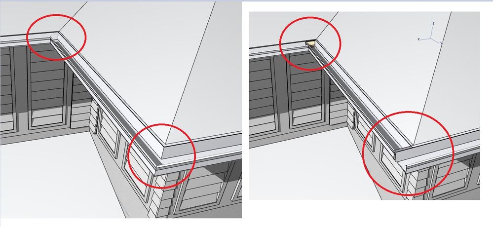

Ive encountered this small issue where using a complex profile with a beam isnt connecting properly at corners.
I have two exact same houses, one the beams work perfectly as I need, and the other encounters a weird issue, even if I Drag a copy from the one which works to the other, it ends up the same way.
Could someone help with what might be causing this?
Thanks.

Are the beam reference lines trimming properly in plan?
i.e. no gaps or overlaps.

If is not what Barry said, could also be the layer intersection Level.

Are they exactly the same complex profile? If they aren't then you may have different materials in the complex profile.
Are you using modules?

Not too sure what was happening. Maybe was a graphical error as I did the same thing after restarting and there was no issue.

If they are sharing a layer with something else, or touching a layer with the same intersection number, that would cause them react in this way.
Try putting them on their own layer then given them a unique intersection number.
