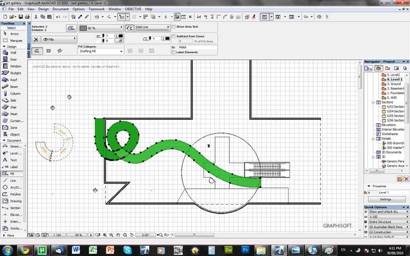

HEELP!! custom curved ramp
has anyone ever created a custom curved ramp in the history of archicad?? it would be the achievement of the century if i could do it just once for an important project i'm working on.
i know archicad has a curved ramp tool but it only lets you follow a circular path not a custom one.
of course you can create a custom curved path as i have done using spline and then slab or mesh tool but this is not a ramp until one end is higher than the other.
I basically want this ramp to go from say 0 - 6 metres high at a uniform gradient.
i have tried objective (much of my hair was pulled out trying to get it to do what i wanted) but my conclusion is that the 'regular profile' does not, will not and never has any intention of following a 'defined' path you give it... only the path that regular profile wants to follow.
i could raise every randomly spaced mesh point individually calculating how high to raise each point each time... this would take 78,000 light years and i have only 2 days to figure it out.
any help is greatly greatly appreciated!!

i will try some of these approaches. thanks for your help!

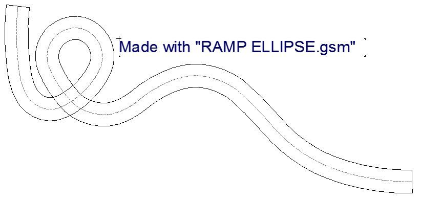

Here's mine RAMP: I used Olivier's object "Ramp Ellipse.gsm".
And 3D View
