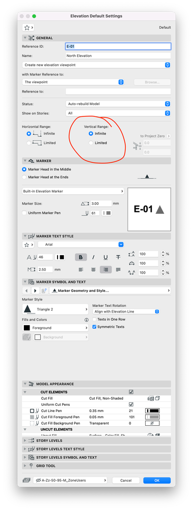

If the dimensions have been added to the View, you may be able to change the vertical range of the elevation in the elevation settings to start at or just below floor level and the dimensions still be visible.

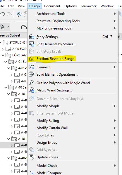

There is also this option (section/elevation range) which is available if you are currently viewing a section/elevation. It shows the limits graphically so you can adjust them exactly from within the view itself.
