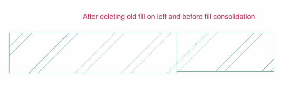

Hi Erich
Maybe since I'm new to your method, I still get line between the two fills even after deleting the fill that was converted.
Below before consolidation but old fill deleted.
See next post for after fill consolidation.

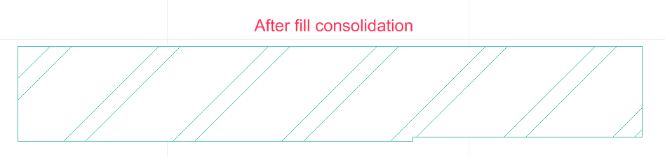

lec
After fill consolidation.
Reread Davids remark,
Ok I get it now.
Thanks all.
