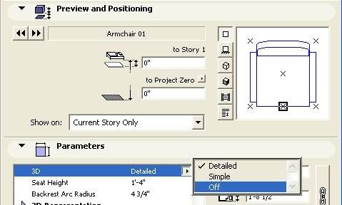

With many Library Objects (e.g. furniture) you can set the 3D parameter of the object to OFF. So in case you don't want to see chairs or bathtubes or toilets in 3D, you can turn their 3D representation OFF.
That also helps to reduce the number of pieces to be modelled.

well i see
then i will improve the memory of my computer and try your recomendations thanks
