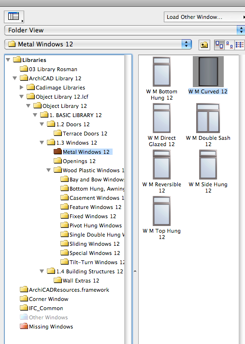

Hi Jamie,
is this what you're after?
Mike
Window in plan

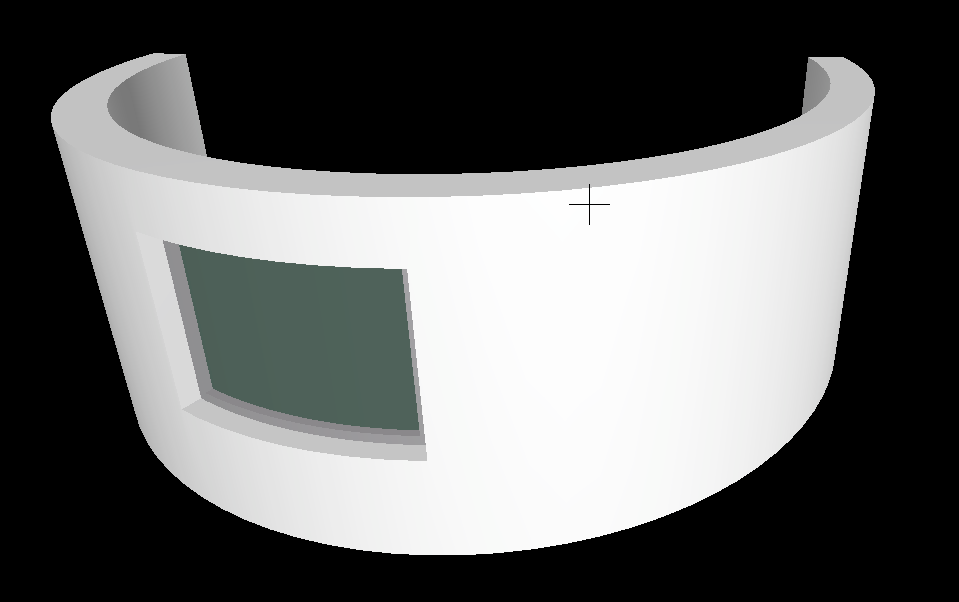

3D
