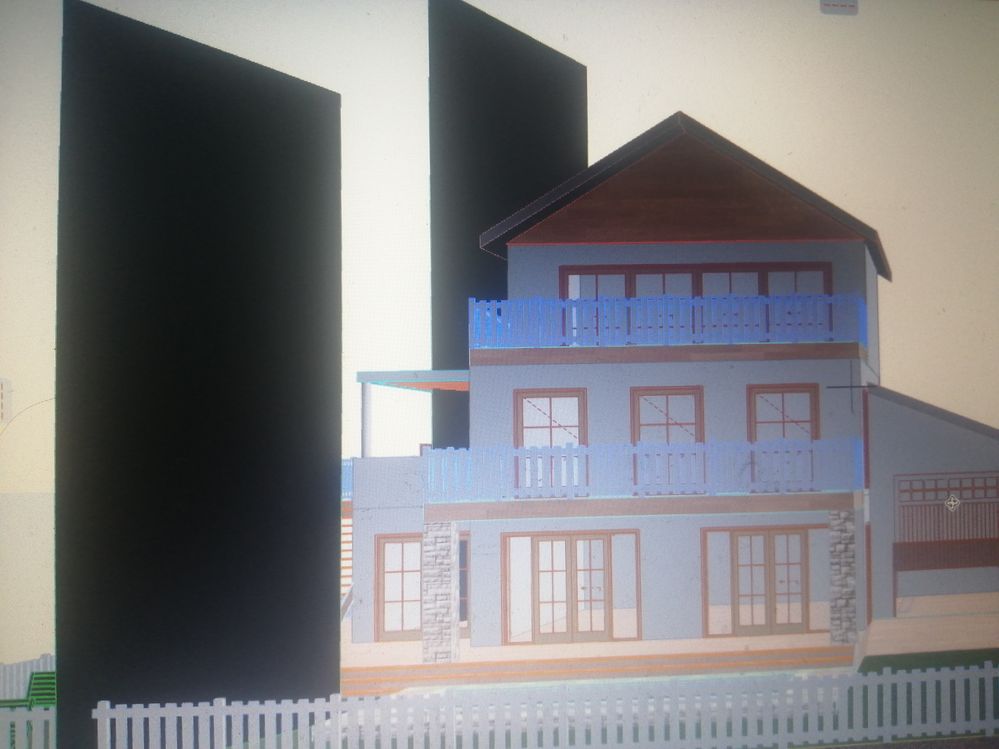

Hello, could anyone please tell me why all the objects I use look like this? Thanks in advance

Check the Model pane in the Object Settings, it may be set to Override Surfaces. If the Model pane is not visible, go to Work Environment > Tool Schemes > Tool Settings Dialog Boxes > Object Tool and make the Model pane visible, it may be hidden in the default WE.

What objects are you referring to and what is wrong with them?
I am guessing there are supposed to be images of trees on those billboards?
If so, what object is that and do they appear correct in the 3D preview of the object?
Erica Ravel
I am referring to all the objects (everything was fine before, I don't know what I did to make them look like that). They look like black blocks. Yes, the ones on the picture are trees, and they appear the same in the 3d preview

Erica:

Erica Ravel
It worked. Thank you😊
