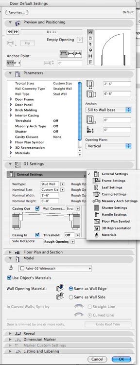

This option (Projected) didn't exist in AC9 and I was able to show doors realistically in the plan drawing; I want to show casings, different line weights, etc. to show the character of the door.
The other option within Floor Plan Display is "Symbolic" and this shows a very stripped down diagram of a door - but when this is chosen, the door is open.
So, my goal is to show a door in the plan that is open AND allows me to show details such as casings, etc. Does anyone know how to do this? Or do you know how to get the "Projected" setting to not override the 90 degree door opening on plan?

mc0m wrote:Under 'general settings' change '2D Detail Level' from scale sensitive to a larger scale (1:50 or equivalent).

2007-11-15 09:23 PM
Maybe my door settings interface is different but I don't see that window?
Mine is pictured below:

2007-11-15 10:02 PM
mc0m wrote:I think you have hidden it under the drop down box! That is where it is on mine.

2007-11-15 10:05 PM
Peter wrote:That did it!mc0m wrote:Under 'general settings' change '2D Detail Level' from scale sensitive to a larger scale (1:50 or equivalent).
Thank you very much!
Edit to add: Yes, your interface is different from mine - but I finally found mine.
