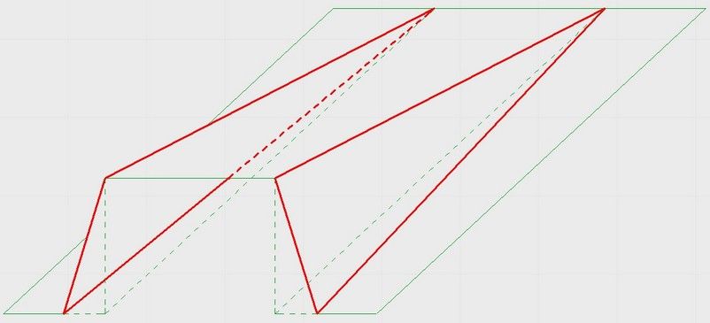

Hi. I'm just begining to discover the features of Archicad 9, but i must tell you I try difficult to resolve a special roof. In fact, I try to create a roof dormer, with sloped roofs on sides. I attached a simple drawing with what I want to obtain. I simply can't create this dormer in Archicad. Need help, please. Thanks.

If those points are defined in 3D you can set your roof out with these points in the 3D window, and the roof will slope to suit the geometry.

Wow, thanks, it's works like a charm.

Stuart - I think you need to get an award for the briefest successful explanation in AC-Talk history.
I had to go to these lengths, and you sum it up in less than 30 words.
Impressive mate, verrrrry impressive!
