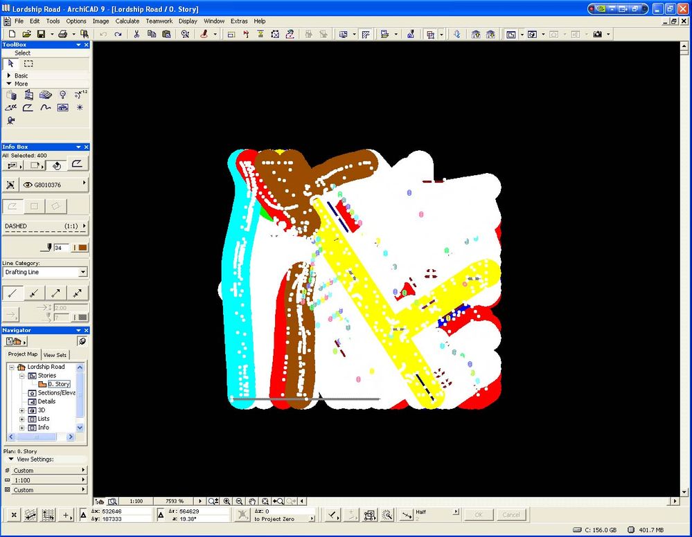

I imported a *.dwg file of a OS map. The lines are too thick to even read the drawing. (see pic)
What am I doing wrong?

Have you looked at your pen settings? It looks like the ACAD pens are mapping to some hugely fat pens that you must have in your setup, but never actually use.
You can see things OK (temporarily) by switching to hairlines, but the real solution will be to review your pen table and DWG import settings.
It can't be a scale problem as you are viewing the drawing at 1:100 which is presumably much larger than the intended scale for a site plan.

On importing DWG files, the scale is set in the window of the Translator set-up, under the "Settings in selected translator". The "Drawing Units" settings give you the option of opening with the setting of 1 DXF/DWG unit to the unit you specify.
The other issue to mention is to make sure of your drawing settings before opening the file. Open a blank drawing in Archicad and set your scale to the output scale of the file you are bringing in. Then proceed to open the DWG and the text and displays will match the desired output to size. This step is made necessary due to the non-scaling text in other formats. Text in Autocad is set to a size and drawn (no consideration of scaling is taken) so to use drawings at different scales, the text must be inserted twice at the 2 different sizes. When the text is brought in to Archicad it is figured to a font size to match the size relations with other elements in the drawing. When changing the drawing scale of the drawing in Archicad, the text will then hold this font size and will change.

As the other guys said you have to set the drawing units in the translator. In you case I would guess that the original unit in the file are meters and the translator interpreted them as millimeters (here in the states the surveyors use 1 foot as the drawing unit and architects us 1 inch so you know what happened when something is twelve times bigger or smaller than it should be).
You can fix it after the fact with the Resize command in the edit menu. They don't call it Rescale because AC works strictly in world dimensions and scale has to do with paper sizes.
