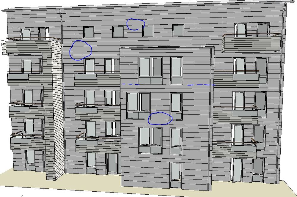

I created a symbol fill representing a panel wall just as I'ver created many before. Now the fill doesn't show correctly in elevation and 3D (internal engine). Any clues? The pattern was created with normal lines which I copied and pasted into the new fill...
See attachment.
Happy for advice!
/Mats

Looks this this is occurring where you have floor slabs; is this correct?

No, check new attach. All walls are cut by slabs by SEO and no slab edges align with the wall outside surface. It seem slightly random where the missing fill pattern parts occur. However it always happen where there are slab edges (fill line dissapear) or top or bottom of windows (parts of line dissapear).

isn't this only in the OpenGL window?
What if you create a 3D document or rendering with the internal engine (with vectorial hatching on)?

3D doc still corrupt

It works so far if I in the 3D window change the 3D engine from best to draft...

This might be a little too late opinion. That looks like an anti-aliasing problem
