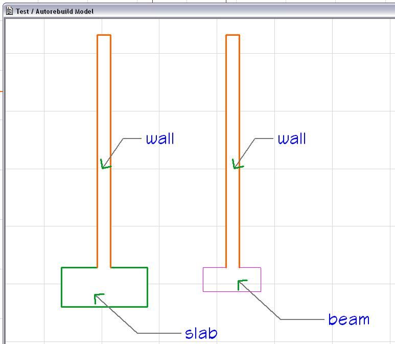

I (not unlike other people, I think, based on my review of previous posts) am having trouble with creating a simple footing. I have tried using a wall element for the stem and another wall element for the pad. The problem with that is that the hidden line looks good in plan, but should not be hidden in section. The best I can come up with (besides the "footing" in the slab extras is a using the beam tool. Problem with that is the corners of the stem become clipped, and in section, there is a horizontal line between the stem that should not be theres. Any help would be greatly appreciated.

The Answer to "clean" intersections in the Section window usually is the matter of what fill pattern is associated with the objects (Wall, slab, beam, etc..) If you want the objects to be seamless at the intersection, they must have the same Fill pattern in the Section. Make sure that the materials that are assigned to the "footIng" (regardless of the tool used) and the "stem wall" have the same fill pattern.
Thanks for the response. Will that work if one object is a beam and the other a wall? Or between a wall and a slab?
Short Answer.... Yes
Short Response: Thank You!
