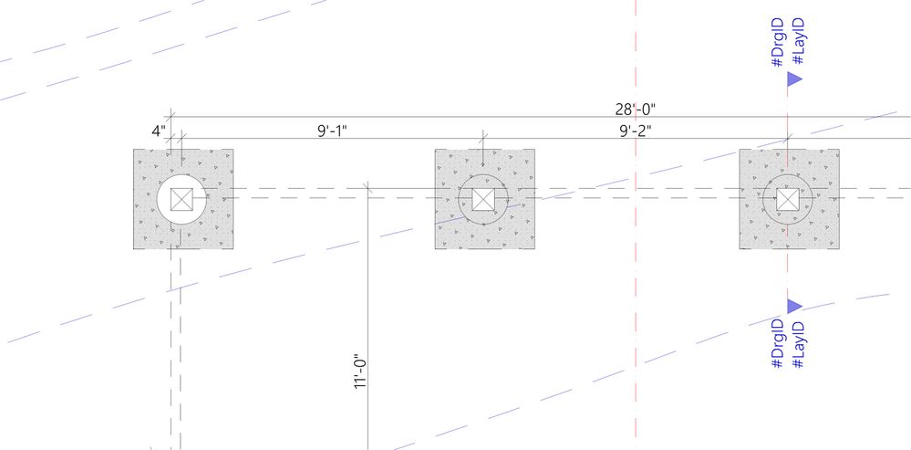

You can see in the screen shots that on the left I am able to show the Sona Tube as white circle with the 8x8 post on top, and all on the footing properly.  That's what I want, but when I place that same saved View on a sheet the round Sona trube columns goes to concrete, or looses it's fill.  I am overriding cover fill with 100% and white.  Whatever I change it to (say red), but nothing on the placed view??? This is the Column tool.  Bug or me missing something?
Thanks

So...Indeed the logic of the drawing should have been to follow the saved view.
I' ve seen that you are not saving a view but instead you are placing the floor plan on a layout.
So I saved a view and placed it on a layout and indeed the column changed to just the contour. I do no know why this is happening. Maybe it is  a setting or a logic....or bug...?
I any case:
I see that all the columns are set to "symbolic cut " instead of "projected" , which might be wrong for the foundation plan, so if you change the floor plan display of the columns then they will show as they should be.  Just check the cut level plane height and set accordingly all your elements.

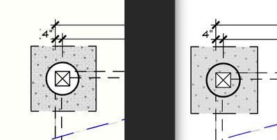

This is a screenshot from the layout.
I any case:
