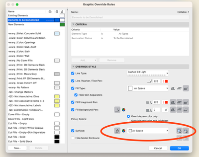

I'm trying to indicate demolished elements on my proposed drawings.
I've set up the renovation filter to over-ride the demolished elements so that they show up as a red dashed outline with a transparent background.
It works in plan but doesn't in section and elevation.
In section and plan demolished walls still have a solid fill (so they hide a lot of the proposed info)
Is there a way that I can set uncut surfaces in section and elevation to show as transparent?
I cant seem to find where to change it.
Thanks in advance.

Eduardo Rolon
@JLopes answer is strange and not on point. I don't like that GS is spending too much time developing stuff that is not needed for architecture but that is not the case here. The Renovation overrides have worked like that since they were introduced.
In order to have Demolition elements show as transparent in section/elevation the only item you need to change is the override material.
Floor Plan
Elevation
Remember that elevations and sections use the 3D model so the override needs to include a Surface override. Floor plans use 2D elements so the overrides are fills and lines.

Awesome. Thankyou.
I changed the surface to 'glass' but, of course, transparency was turned off in the section settings!
Tom
Eduardo Rolon
Take in consideration that if you turn transparency on then all windows, cws and doors will become transparent too which is not the correct graphic standard. So in this case it might be a good idea to duplicate that elev/sect so that you have correct graphical representation on all others.
