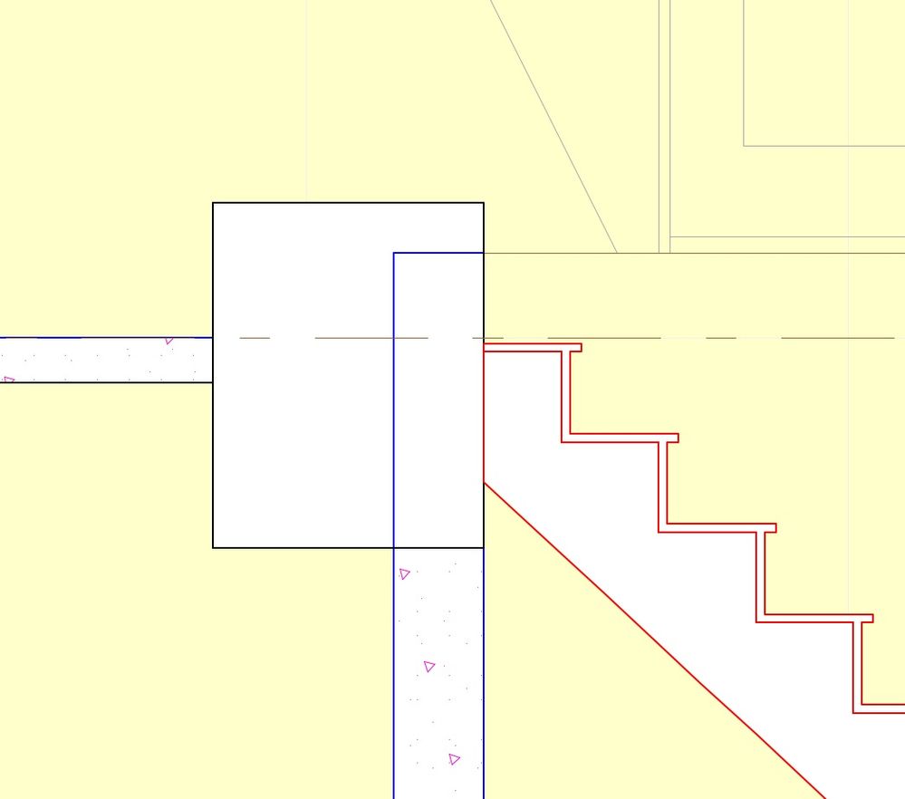

Our office is in the midst of going mostly 3D for our construction documents and I need a little help.
I understand people use "things" on hidden layers to help with SEO's. What type of "things" do you use? I'm building a stair and want to cut a piece of it out. I've used a beam that I'll place on a hidden layer to act as the operator. After the operation, when I shut the beam off, It's affecting other pieces of the model (mesh and slab). How do you go about doing this? Should I not use a beam?
7 Replies 7
After SEO, looks ok.
Why is it doing this? I did not include anything else in the SEO...
Beam priority is also set to 0

I did it using a slab with no problems. Should I just not use beams in this situation?
Change the layer priority number for either the layer of the slab or of the beam (I would change the beam).
Aahhhh, I see, the intersection group number in the layer dialog box. I've never used this because I never knew it existed, but now I see the power!
